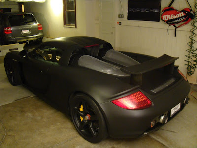

<t><p><b>ALGUEM DISSE PINTURA FOSCO RSRS <img src='http://4.bp.blogspot.com/_BvaW3NOxemU/Sg2F6RhPduI/AAAAAAAACsk/vZzfCGc3Ny4/s400/untitled-5.jpg'\> </b></p></t>
<t><p><b>zazaxavier escreveu:</b> </p> <p><b>ALGUEM DISSE PINTURA FOSCO RSRS <img src='http://4.bp.blogspot.com/_BvaW3NOxemU/Sg2F6RhPduI/AAAAAAAACsk/vZzfCGc3Ny4/s400/untitled-5.jpg'\> </b> </p> <p>http://www.youtube.com/watch?v=USpnRdWrSIA </p> <p><i>é parece que sim,é demais!!!</i></p></t>
